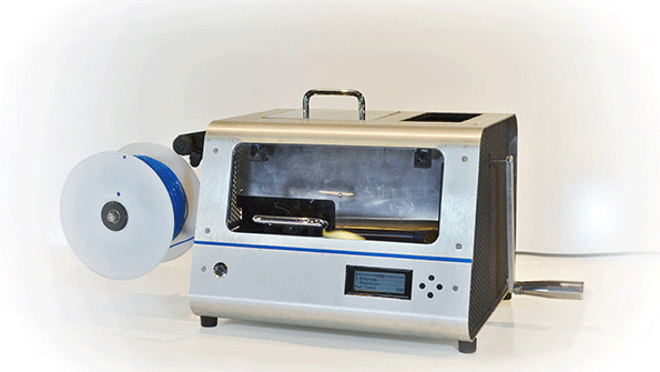

Production of the ProtoCycler, which is capable of grinding and re-extruding plastics for 3D printing, began after a successful crowd-sourcing campaign.
Crowd-sourcing was able to raise over $100,000 in about a month to fund the production of the ProtoCycler. Extruding at 10 ft. per minute, the ProtoCycler produces a 1-kg spool of filament in about two hours. Other companies offer similar products; for example, Filabot allows anyone to make their own filaments and recycle plastic.
