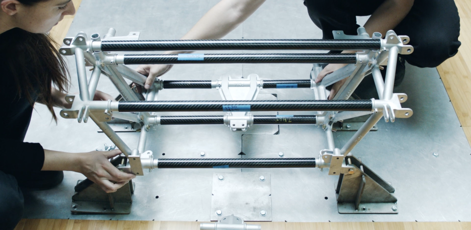

DM’s solution lies in the manufacturing process, where “nodes,” or 3D-printed aluminum joints, provide durable interconnection between aerospace-grade carbon fiber rods. The nodes and rods make up the car’s chassis or framework, and have a very low manufacturing cost. A small team of designers at the microfactories assemble the nodes in an effort to “design, build, and scale a wide range of complex vehicle structures.”
Team members at a microfactory use inexpensive 3D-printed nodes to assemble the chassis of a sports car. Teams can custom print parts to build virtually any model they choose.
DM’s first microfactory produced a prototype that features a 100-lb. chassis, which is about a tenth of the weight of a normal car. Its specifications are impressive, producing only a third of the emissions of an electric car, and costing only 1/50th of a normal factory’s capital cost. It accelerates from 0 to 60 mph in about two seconds and has double the power-to-weight ratio of a Bugatti Veyron. The framework and car are strong enough to support a 700-hp internal combustion engine and is claimed to be even stronger than the chassis of traditional vehicles.
