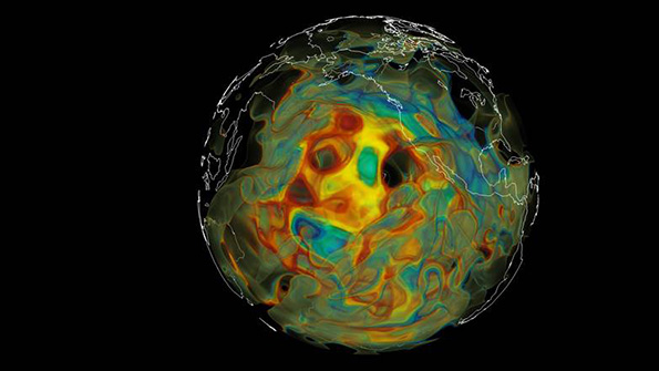

Supercomputers like Summit the one ORNL will get in 2017 let researchers address challenging problems such as recreating shearwave perturbations inside the Earth due to seismic activity
