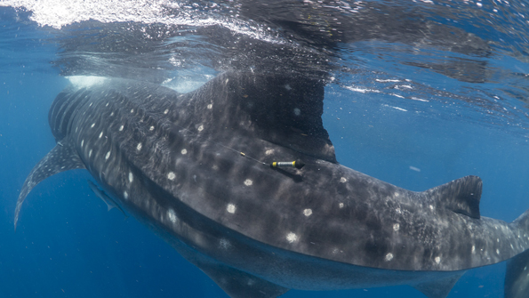

Researchers fit a tiger shark with a SeaTag. The tags are made using SLA that uses powdered nylon instead of liquid resin. The material is strong, and fine layer thickness (16 to 30 μm) makes the molds smooth, which in turn makes smooth casts. Courtesy Jim Abernethy, RJ Dunlap Marine Conservatory

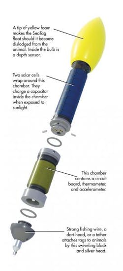

SeaTags record acceleration and water temperature and depth to monitor the animal’s reactions to its surroundings. Future tags will have sensors that monitor oxygen levels, water salinity, and even pollutants like oil dispersants. Desert Star is also developing SeaTags for marlins, otters, sea turtles, and dolphins.
Desert Star slowly casts the SeaTags in epoxy and cures them over 24 hr so the two circuit boards embedded in the polymer don’t melt. (One circuit board houses a magnetometer, accelerometer, micro-SD card, and thermometer, while the other holds the transmitter that sends sensor data to the ARGOS satellite.)
Ribs support delicate features until the epoxy fully hardens. Technicians remove the ribs during postprocessing.
After curing, portions of the tags are wrapped in thin solar cells. The cells outperform batteries (which tend to be bulky) and traditional photovoltaics (which make electricity only from abundant solar radiation — in short supply underwater.) The thin-film cells collect sunlight for power and use it to charge a capacitor, which powers the tag’s other subcomponents.
