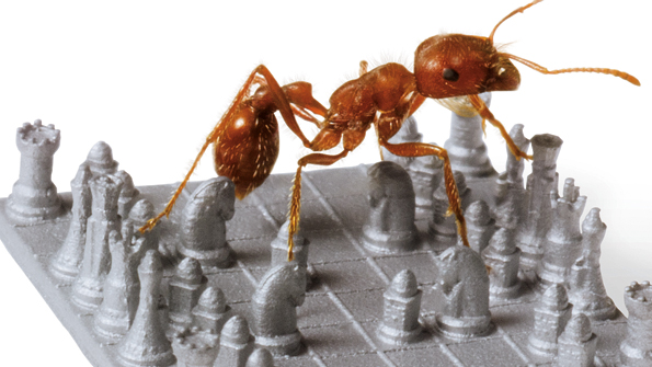

These metal parts show the range of 3D metal printing and casting at FineLine Prototyping. They include a small metal linkage, a cobalt-chromium heat exchanger components, and a small chessboard (with an ant to show scale).
