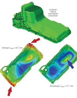

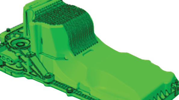

Isotropic analysis of a composite oil pan reveals a maximum deflection of 4.1 mm and two potential failure points.

The accompanying figure labeled Isotropic versus anisotropic simulation gives proof to this theory. The red arrows indicate isotropic analysis of two potential failure points on a composite oil pan. Anisotropic analysis reveals the part does not deflect excessively at those points. An engineer relying on the isotropic analysis would likely add more mass to guard against failure which will not occur.

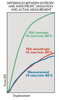

Another example of isotropic versus anisotropic simulation is visible in the chart labeled Differences between isotropic and anisotropic simulation and actual measurement. The blue line is an FEA comparison curve and represents the actual physical measurement of a composite prototype. The variance in results between the isotropic analysis and the physical measurement is more than 80%. The anisotropic analysis curve closely resembles the physical testing.

The isotropic analysis varied 85% for the 20% material and 120% for the 50% material. The anisotropic testing produced a curve that differed from the physical measurements by only 5% for the 20% material and 2.5% for the 50% material.
Clearly, the anisotropic results produced a smaller variation between simulated and actual results. This helped the companies find an optimal design. If the companies relied on the isotropic analysis alone, the variation between the simulated and actual results would be too large and unpredictable for engineers to design with the maximum possible precision. Instead, they would overdesign to avoid failure.
