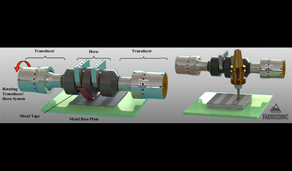

2. Fabrisonic is able to make complex metals with embedded electronics by using an ultrasonic horn and metal tape.
Additive manufacturing (AM) processes are starting to gain speed under the label of 3D printing. Fused filament fabrication may have the media’s attentions, but a novel technique I found in my research was Fabrisonic. The company uses an ultrasonic welding technique. One process involves unspooling foil over an ultrasonic horn that is mounted on a three-axis machine. At 0.006-0.01 in. thicknesses, the foil is capable of maintaining predictable materials properties while being engineered into customized products with embedded sensors or complex interiors. This technology has been used in many applications involving aerospace, oil and gas, and military. Traditional metal foil can be ultrasonically welded layer-by-layer. With this process each layer—or part of a payer­—could be a different metal foil to create a complex part with unique properties. This could play an interesting role in radio frequency (RF) components where many small metal components are tediously built by hand.
