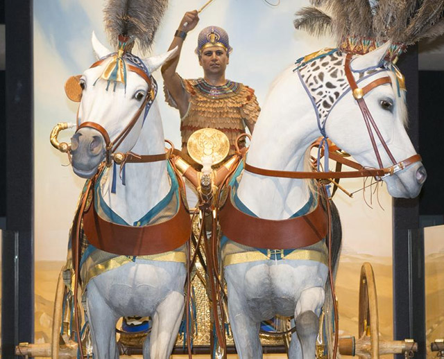

1 The Crossroads of Civilization exhibit at Milwaukee Public Museum features a lifesized sculpture of King Tut based on his mummy The chariot is based off of actual chariots found in his tomb and the horses39 design is an artist39s rendition of ancient Arabian horses

Using 3D-scanning technology from Creaform, experts from the Milwaukee School of Engineering (MSOE) invented a way to let visitors observe ancient Egyptian artifacts up close. Over the course of three days, they scanned over 30 items at the Milwaukee Public Museum (MPM), including a life-sized sculpture of King Tutankhamun on his horse-drawn carriage, so that visitors can observe astonishing details from 3D virtual models on their tablets.

Based off of CT scans on his mummy, MPM’s sculpture accurately portrays Tut’s body type and facial structure. Embellishments on his armor and horse-drawn carriage are true to ancient chariots found in Egypt and artifacts in his tomb. Using the Go!SCAN 20 and the Go!SCAN 50, Vince Anewenter and Jordan Weston from MSOE’s Rapid Prototyping Center (RPC) scanned clothing and riding gear layer-by-layer. The Go!SCAN 50 was used to create a general contour map by recording the way the sculpture reflects light.
The specialists then switched to the Go!SCAN 20 in its "Natural Features” mode to capture more intricate details at a higher resolution and in full color. After scanning, the experts resolved any holes in the images using post-treatment software called VXmodel. They then transferred the 2D watertight color images to multimedia software, and projected them onto a 3D model.
In addition, a "matching point" feature on both scanners ensured continuity as the experts switched between scans of individual layers of clothing. By setting reference points on a pre-saved base model, the experts could keep track of the orientation for each layer.
