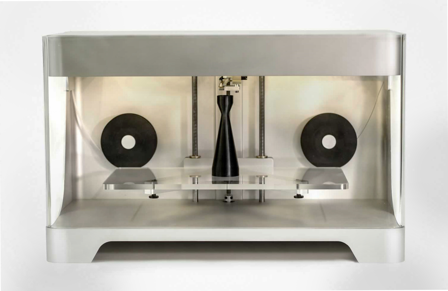

The Mark One printers — roughly 13 x 14 x 22 in. to make parts to 6.25 x 6.25 x 12 in. — are the first in the world to 3D print carbon-fiber parts. That pairs the unbound potential of 3D printing with the advantages of high-strength material — through a process MarkForged calls Composite Filament Fabrication (CFF). Parts made with CFF are printed in a thermoplastic matrix of layers that incorporate continuous strands of reinforcing fibers. The long strands carry loads down the entire part, for a stronger part overall.
The Mark One uses free (but proprietary) software that can import .STL and .OBJ models. That's partly because the CFF printhead needs special software to operate correctly and execute path-planning algorithms to maximize part strength for every print.
More specifically, CFF-built parts are up to 20 times stiffer than ABS plastic, five times stronger, and have a higher strength-to-weight ratio than 6061-T6 aluminum. That lets designers to 3D print functional parts that would otherwise need to be CNC machined.
"We removed the strength limitations of 3D-printed plastic parts," says Greg Mark, founder and CEO of MarkForged. He also says that the printer is made to be user-friendly like most other desktop 3D printers.

The printhead uses a dual extruder that combines traditional 3D printing and CFF printing in a single part. Designers can choose between lightweight carbon fiber, low-cost fiberglass, or Kevlar for puncture and abrasion resistance.
The printer also supports traditional 3D printing (FFF) with nylon and PLA plastic.
The Mark One has a precision leveler with a quick-release print platform so users don't have to monkey around to make it plumb.
The Mark One's leveling device helps the machine output parts to 100 µm (for normal FFF printing) and 200 µm (for the CFF printing of continous carbon-fiber strands).
At the end of my booth tour, I got to see two finished products — a couple samples of what the Mark One can make.
The team's samples include one part with a nylon base (for a tough outer shell) sandwiching layers of carbon fiber that impart strength. (This particular sample has 3 x 200 µm layers of carbon fiber on the top and bottom for six layers in all.)  To allow for a bit of comparision, Mark then invited me to flex an all-nylon part of the same geometry — a part that proved (surprise, surprise) far less rigid than the reinforced one.
