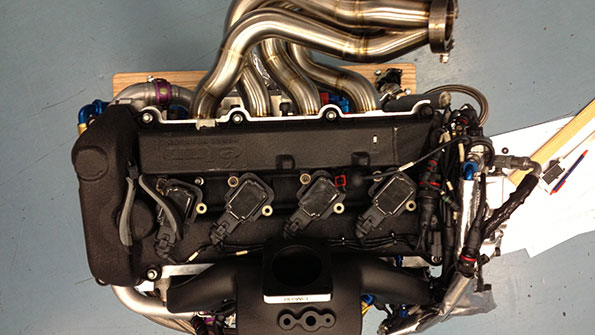

A 3D printed intake manifold for a DeltaWing race car was made out of Windform XT 20 in order to simplify manufacturing and decrease the weight of the automobile all while withstanding high temperatures and pressures of the gearbox oil

The new availability of this robust 3D-printing material also allowed the team to make other key changes to benefit the car. Windform XT 2.0’s resistance to high temperatures and pressures allowed the DeltaWing team to redesign oil flow and gearbox structure to reduce parasitic losses. The team easily fabricated an otherwise complicated 3D-printed piece with integral oil drillings, a task that would typically require a 5-axis manufacturing process.
In addition to the new gearbox design’s transmission seal covers with pressurized oil-feed passages, the team used Windform XT 2.0 to additively manufacture electronics enclosures, electrical breakout boxes, and a tow hook plinth. In the prototyping and tooling phase, Windform XT 2.0 was applied in brake inlets and ducting, air inlet ducting, and filter enclosures.
