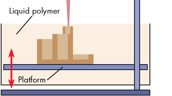

The SLA laser travels through the liquid photo-resin, building the part layer by layer.
SLA is a photopolymerization process in which a build tray is submerged 0.002 to 0.006 in. (0.05 to 0.15mm) in a basin of liquid photosensitive material. This depth can vary based on laser strength, material, or tolerance desired. A UV laser (not lamp) solidifies one slice of the part onto the build tray. The tray then submerges, another 0.002 to 0.006 in., and the laser solidifies the next slice of the part. The thickness of the layers can affect the quality of print and tolerances. An industry average tolerance is around 3.9 × 10-3in. (0.1 mm). The laser travels the entire path of the part’s cross-section as it builds up each layer, so speed becomes an important consideration.

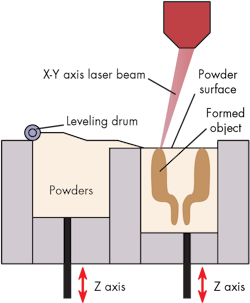

After the part is formed in the powder-bed process, it’s removed and cleaned for any post processing. The powder that’s left un-sintered acts as a support material; after the process, it can be sifted and reused.
In powder-bed SLS, a layer of powdered material is carefully laid down by a leveler or roller on the build tray. A laser then sinters the cross-section of the part. Subsequently, the tray drops another 0.002 to 0.004 in. (0.05 to 0.10 mm) and the process repeats. Similar to SLA, layer thickness varies based on laser strength, material, or tolerance desired.
A variation of SLS is called the cladding process. One way to clad is via powder jet, whereby a print head sprays powder to form layers as a laser sinters each layer. The powder-jet cladding process may be used to fix broken or damaged parts. Users can even align the grain structure of the new material with that of the existing part, an important consideration for corrosion resistance. Often times, cladded parts require post machining.
Some 3D printer companies offer a three-step process in which one machine clads (puts one material over another), measures, and grids the part to the desired tolerance. These processes often use fiber lasers, rather than CO2 lasers, to lower operating cost and make control simpler.
SLS economical printer can cost anywhere from $12,000 to $33,000.
