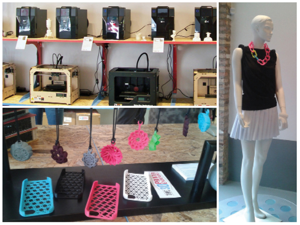

Located in the Whirlpool Building on the Chicago River sits a small shop that helps explain 3D printing to residents and tourists walking about the Windy City.
The 3D Printer Experience in Chicago offers 3D printing, 3D scanning, private events, and workshops.
The 3D Printer Experience LLC houses over 20 printers of various brands and offers services like 3D scanning, 3D printing-on-demand, and scheduled tours and classes. Cofounder Mike Moceri helps teach the workshops. Moceri shared his experience with desktop 3D printers. He says, “My favorites are the UP Mini for its support-material generation and ease of use, the MakerBot Replicator 1 Dual for its versatility and quality, and the SeeMeCNC Rostock Max for its size capabilities and high-speed delta robot mechanisms. However, for the best quality of prints I’ve seen, SLS printing on an EOS Formiga P110 is the gold standard for surface quality, part strength, and dimensional accuracy.” Moceri further explained the desktop-printing process.
