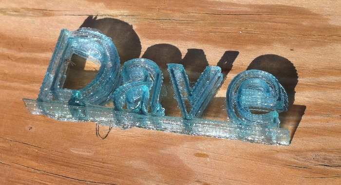

In short, the parts the Peachy builds don't yet have the geometric precision or strength of high-end OEM parts. No doubt, most of the Peachy's backers (3,272 on Kickstarter at last count) understand this. Thus is the nature of maker-level 3D machinery and design in general.  In fact, if you've ever "won" a product by donating on Kickstarter and have a similar or different take, drop me a comment below. I recently came to see how anyone looking to get a product off of Kickstarter must have a tinkering spirit and realize that Kickstarter-type items are not perfectly optimized turnkey products. Last week, I bought a production-run unit of the Windowfarm hydroponic lettuce-and-herb grower, and found that I needed to retrofit the design with some hose to get its air lifts to work properly. It took a trip to Home Depot (of course), about an hour of fiddling, and rags to mop up a watery mess to get it right.
In any case, Peachy's creators are working to improve the machine's output parts. (See below for the latest results, with details of precision that looks to be about 0.0625 in. or so.) The nearly half a million dollars Canadian the Peachy team has raised for the project should certainly help on that front. We'll be keeping an eye on them ...
