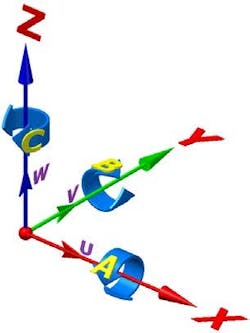

Multiaxis machining, also known as 5-axis machining, represents a revolutionary approach to subtractive manufacturing. Unlike traditional 3-axis milling machines that operate along the X-, Y- and Z-axes, multiaxis equipment introduces A- and B-axes, allowing movement in multiple directions. The A-axis rotates around the X-axis, while the B-axis rotates around the Y-axis. This additional flexibility enables machining in four or more directions, with some advanced machines boasting up to nine axes.

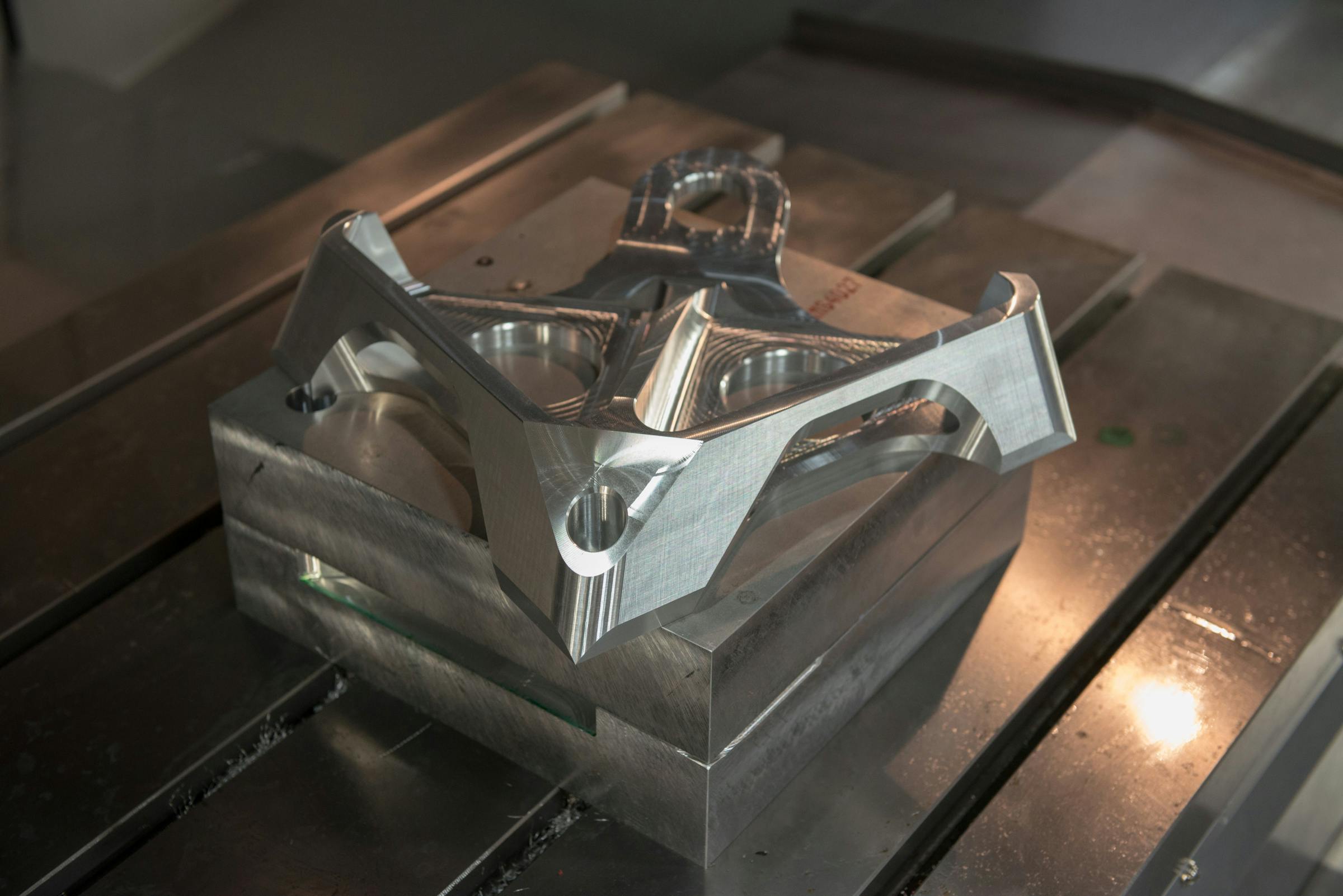

The benefits of multiaxis machining become evident as you realize its potential to minimize setups. 5-axis machines offer a broader range of motion, allowing them to machine around work-holding. This translates into increased accuracy and reduced human error, at the same time eliminating the need to design fixturing for each step in the process.
Improved surface finishes are another advantage of multiaxis machining. The ability to use alternative cutting tools, such as shorter tools with less vibration and deflection, results in superior surface quality. Additionally, the elimination of blend areas contributes to achieving truly remarkable surface finishes.
