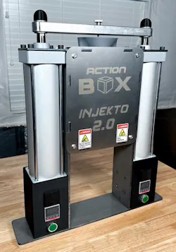

Many people don’t realize that an injection molding machine is something they can build themselves, even without a machine shop or other extensive setup. The hosts of the Canadian YouTube channel Action BOX—known to viewers as brothers Alan and Dave—described in one of their videos how they created a desktop injection molder called the INJEKTO.
Even though the YouTube channel only appeared on June 14, 2021, some of the videos have several million views. All the Action BOX content aims to show people how to do and build things, encouraging them to have ideas in the process.
Here’s an in-depth breakdown of what the Action BOX team did and why certain design decisions were made.
The Body and Frame
The design of the molds used in this manufacturing process plays a substantial role in determining whether the resulting products will function as intended. The same is true when making an injection molding machine. The design is critical for the machine’s overall functionality and performance. That’s why the Action BOX team used computer-aided design (CAD) software to flesh out the build’s specifics before making the physical version.
The creators focused on user-friendliness in the design. Two main components that make the machine work are an air compressor and a standard electrical socket, making it easy to use almost anywhere.
Much of the machine’s body consists of a 3-in. aluminum flat bar. The creators chose it because they deemed it one of the least expensive and most readily available types of raw aluminum to source. However, your decision may vary depending on your budget and how you plan to use the injection press.
The Structural Integrity
During the design process for the machine’s frame, the pair recognized that they could have welded the parts together or made them slot into each other to create support. However, simplicity was the goal, especially because they knew some people who build this product might not have machine shop access. The design includes well-placed brackets to hold everything together.
One of the brackets also serves as a shelf for the metal bar pulled down with pneumatic cylinders during the machine’s operation. The brothers decided putting the bracket there would increase tolerance to the resultant high stresses.

The creators begin by plugging the machine into a 110-volt power supply and giving it a couple of minutes to reach the required temperature. The display on the front of the device indicates when the temp is correct. The team used acrylonitrile butadiene styrene (ABS) plastic, so they knew the right nozzle temperature was approximately 220°C.
They plugged the air compressor into the back while waiting for the machine to get hot enough. Doing that forced the side cylinders up, putting the injection ram in the right position for pressing hot plastic into the mold.
READ MORE: Small Parts: Design for Micro-Molding Fuels Miniature Component Applications
The creators filled the injection tube with plastic, then inserted their mold. After pushing the mold upward, they placed a spacer below it to maintain contact with the nozzle. However, the creators also suggested elevating the mold on a scissor lift, provided both components are small enough to fit under the machine’s nozzle.
Next, they pressed the injection button and kept it depressed for a few seconds longer than necessary, giving the plastic time to start cooling and hardening. Waiting like that prevents the plastic from flowing back out.
The machine’s creators were also curious about how much plastic it could hold, so they filled the injection tube, extruded all the material out and placed the contents on a scale. The results showed the machine contained 27.6 grams—more than sufficient for home projects.
The molds were created on a CNC machine. However, you can also explore other options, such as using a 3D printer to make what’s needed for your project.
