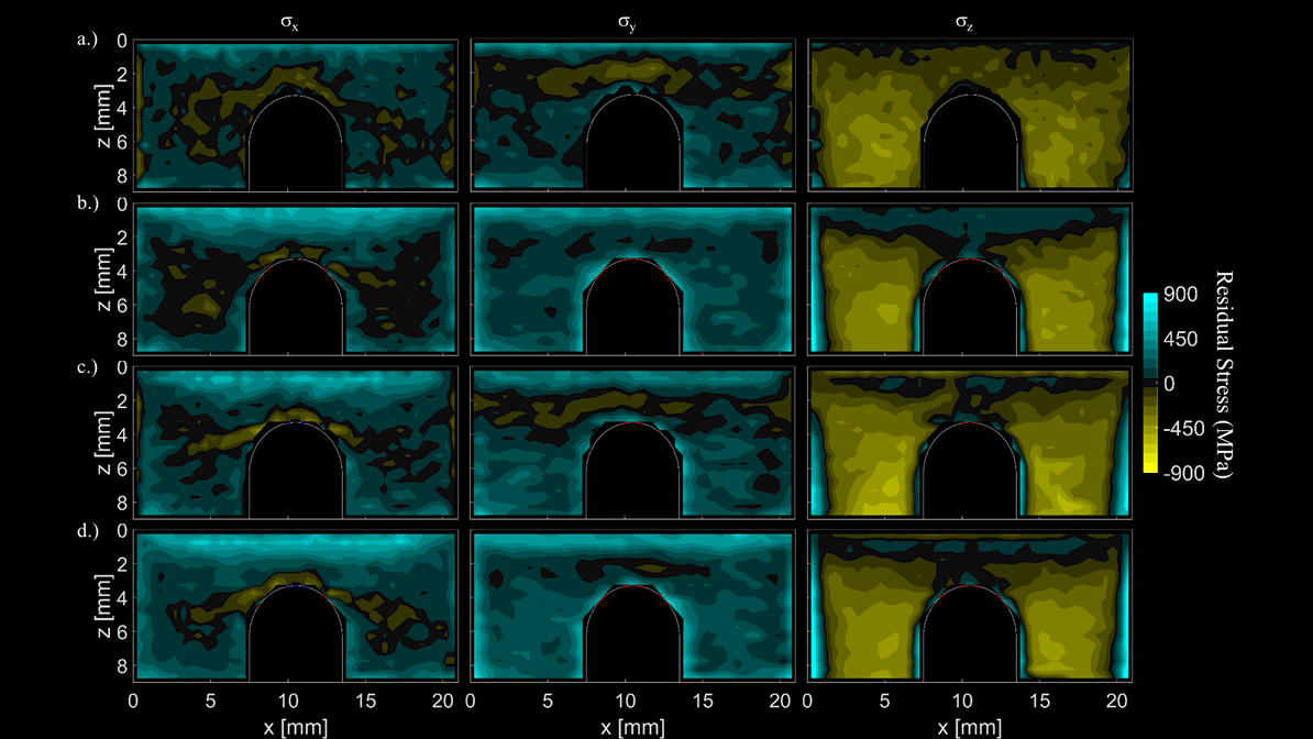

For the study, the researchers printed four titanium alloy bridges just over 2 in. long (2 cm). The samples were built with either continuous or island scanning, with lasers running along their length and width or at a 45-deg. angle.
High-energy X-rays generated by a powerful synchrotron were beamed deep into the samples. By measuring the wavelengths of X-rays reflected off the metal, the team could accurately “measure” the distances between metal atoms. From there, the researchers calculated stress. The greater the distances, the more stressed the metal was. With that information, they generated maps showing where stresses were in the sample and how large they were.
All samples had stresses almost equal to the titanium alloy’s yield strength. When stresses do equal a material’s yield strength, it permanently deforms.
“The island-scan samples have really large stresses on their sides and tops, which are missing or much less pronounced in the continuous-scan samples,” says NIST physicist Lyle Levine. “If island scanning is how industry is trying to mitigate these stresses, then for our particular case it was far from successful.”
In another test, the engineers removed a leg of each bridge from the metal base plate it was printed on. The team measured how far the legs sprung upward when related from the plates. This gave them another indicator for how much residual stress was stored inside the bridge. In this test, island scan samples performed poorly, their legs springing up more than twice as far as continuously scanned samples.
Based on their study, the researchers concluded that island scanning could be a double-edged sword. Although small islands may reduce contraction, they might also cool much faster than larger melt pools, increasing temperature differences and thus increasing stress.
