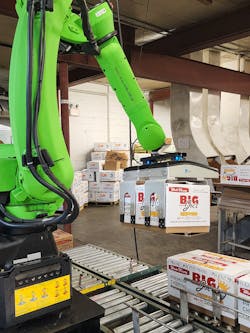

Gibson was skeptical that a small, powerful and dependable palletizing system existed that would meet those demanding requirements. But when John Weeks, CEO of automation integrator WeAssistBots, walked through Gibson’s facility, he was confident he could meet the challenge. Weeks chose the FANUC CR-35iB cobot, with an industry-leading payload of 35 kg (77 lb) and reach of 1831 mm (74 in).
READ MORE: Universal Robots Unveils UR30: Relief for Heavy Lifting
“It brought the horsepower required to do 50-lb cases in the Idaho potato industry, that up until now a traditional cobot couldn’t touch,” Weeks explained. The cobot also combined the small installation footprint and large work envelope that Magic Valley needed. The cobot can stack two pallets at once (one on either side of the robot), reaching easily from floor to ceiling, and actually taking up about 18 fewer inches than having workers in that area.

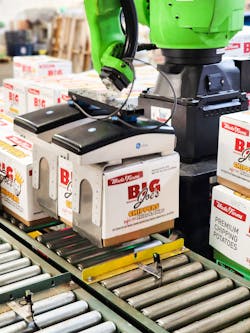

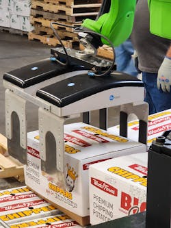

In an innovative approach, Weeks mounted two rugged OnRobot 2FGP20 electric finger grippers on the cobot arm to handle the 52.5-lb boxes. This approach doubled the tool’s individual payload of 20 kg (44 lb).
Weeks credited the quick response from OnRobot’s technical team to make the integration work. When he and his engineers encountered some hiccups with mounting the dual tools, he called his OnRobot contact and received immediate technical support. With the additional information, Weeks and his team of engineers were able to make the appropriate adaptations for a successful deployment.
OnRobot Adaptability and Customizability Solves Gripping Challenge, Inspires Confidence
With the weight and footprint issues addressed, the slip-top box challenge required additional innovation. According to Weeks, that’s where OnRobot really shines. “My favorite thing about OnRobot tooling is absolutely their adaptability and the customizability,” he said.
Weeks attached a metal plate with curved fingers on one side of the dual grippers, then programmed the robot arm to angle the tool so it tucks the curved fingers under the bottom of the box before lifting it. “With the customizability of the 2FGP20 versatile tooling, we were able to get both finger grippers underneath the edge of the box with 40 nanometers of force, compress that box, and deliver it gently and quickly and safely,” he explained.
