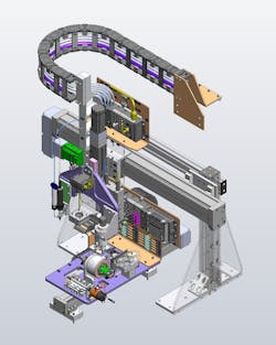

Then, the team came up with a creative mechatronic solution that relied on three ball-screw linear actuators for X, Y and Z motion, a pneumatic rotary actuator and a reliable vision inspection system.
The engineers applied a Festo EGC ball-screw linear actuator for Y axis motion. The EGC and the other axes met the ± 0.1 mm required accuracy for this application. The team mounted a platform onto the Y-axis EGC to hold the housings, covers and required equipment. Housing fixtures like the ones used in the manual process were attached on both sides of a Festo DRVS semi-rotary pneumatic drive with a Festo SRBS position sensor.
After covers were placed to the opening facing up, the DRVS rotated the fixtures to bring the next cover opening to the up position. Rotation eliminated the first bottleneck; there was no need to manually remove the housings and reposition them. The machine did the repositioning.
A Festo EGSC ball screw mini slide was used for Z axis motion. On the Z axis, the KAMP team mounted a plasma gas applicator, a Nordson adhesive applicator, a Banner iVu vision sensor and a Festo DFM pneumatic guided actuator with vacuum cup gripper. The DFM automated picking-and-placing covers, eliminating the second bottleneck. The vision system automated inspection and made it more accurate.
The X axis—also a Festo EGC ball-screw linear actuator—and the Y axis were programmed to work in harmony to trace the precise round, oval and rectangular contours of the openings and to position the applicators, vision system and pick-and-place unit precisely where they needed to be during the assembly process.

In the new automated process, the machine operator places two die-cast metal housings on fixtures and six plastic covers on a cover fixture (three covers for each housing). Vacuum holds the metal housings and plastic covers in place. Manually loading the machine made sense from a cost standpoint and only required seconds. Housings and covers in place, the operator starts the machine.
The X and Y axes position the vision sensor above the die-cast housings and the covers to verify all parts are present and correctly presented. The X and Y axes then trace the contours of the cover openings on the housings and over the plastic covers as plasma gas is applied to prepare the surface for a strong bond. The Z axis vertical motion ensures proper distance between the gas applicator and the part.
READ MORE: Full Automation: The Path to Lights-Out Production
Following plasma application, the Nordson applicator applies adhesive to the perimeter of the housing’s cover opening. The vision system confirms a continuous bead has been laid down, and the DFM picks and places the correct plastic cover. When both housings have covers, the DRVS rotates the housings to the next opening and the plasma, adhesive, vision inspection and placing of covers are repeated. In all, the two housings are rotated three times and six covers are applied in roughly three minutes, a 75% time reduction over the manual process.
