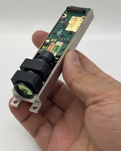

SiLC’s FMCW LiDAR transceiver, known as the Eyeonic Vision Sensor, is a silicon photonic chip that integrates LiDAR functionality into a single, tiny chip the size of a fingernail. “FMCW (frequency-modulated continuous-wave) LiDAR is basically a technology that enables you to directly measure depth and velocity of objects by measuring the Doppler frequency shift of the light that reflects from them,” said Asghari.

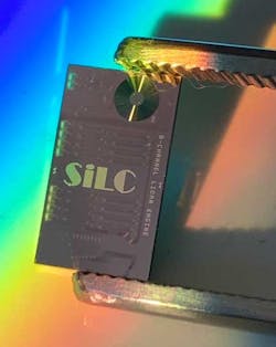

The 4D chip-scale FMCW LiDAR integrates photonic components, such as lasers, waveguides and amplifiers, onto a single silicon chip. The vision system can achieve micrometer-level precision and can see objects up to 500 m away under the right circumstances.
