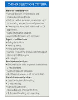

Selecting the Right O-ring
When selecting the type and size of O-ring, design teams should consider four criteria that will maximize seal life and minimize cost: the material, layout, quality and installation.
Engineering teams should tap knowledgeable suppliers for O-ring recommendations based on their experience. There are also several tools to help select and size O-rings, such as Trelleborg’s O-ring Calculator, Compatibility Guide and Sealing Solutions Configurator.
