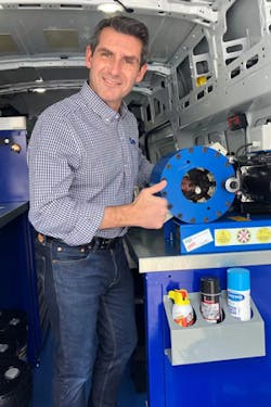

Lacoste’s option includes his investment in two branded vans fitted with a workbench, crimper, saw and inventory of hoses and fittings. “I buy the fittings and hosing from the franchise and then I do the cutting and assembly of the hose specifically for the need of the customers,” he explained. “The various sizes and variety of fittings means there is quite a bit of complexity—I carry about 850 tags of different inventory of fittings.”
