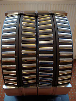

Tapered Roller Bearings
4. Tapered roller bearings are designed to withstand a radial and thrust load, and can be found in car hubs due to the amount of radial and thrust loads they can carry.
In a tapered roller bearing, the rings and the rollers are tapered in the shape of truncated cones to simultaneously support axial and radial loads. The ratio of the loads depends on the angle of the axes between the roller and bearing. The greater the angle is the greater axial load can be supported. The contact angle for most tapered roller bearings range is between 10 to 16 degrees. For higher thrust-load capacity, a 30-degree contact angle is used.
5. Tapered bearings are mounted pairs since they handle radial loads better than a single row of tapered bearings. For heavy-duty applications, two or four rows of tapered rollers are combined in a single unit in large bearings.
