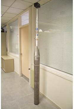

2. The Windcrete prototype sits outside of the Maritime Engineering Laboratory where it was tested. A smaller model of the actual float, it is erected with a water ballast and then loaded with rocks for self-stabilization in wavy conditions. It is designed to carry wind turbines with a power rating of 5 MW, and could be used for turbines that generate up to 15 MW.
