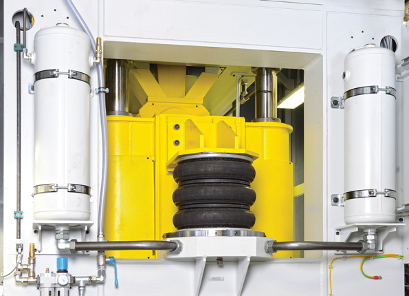

Air actuators work like single-acting pneumatic cylinders for lifting and pressing in many industrial applications.
Finally, a small design height makes them well suited for pneumatic applications in confined spaces. When unpressurized, the compact units can be installed quickly and easily, thereby saving time and money. Yet when pressurized, they provide sizable strokes. For example, ContiTech’s XXL Series double-convoluted bellows has a minimum collapsed height of only 4.72 in. (120 mm) but a maximum operating height of 27.6 in. (700 mm). With a 25.2-in. (640-mm) diameter at this height, it generates 17,984 lb (80 kN) of force, just under 9 tons, at 87 psi (6 bar).

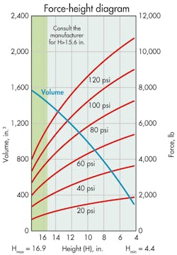

Force-height diagrams relate pressure, volume, force and height. This example is for a triple-convolution actuator with a 12.8-in.-maximum diameter.

When sizing an actuator, rely on a specific air spring’s engineering specs and account for: main dimensions, connecting dimensions, and force-height and volume relationships.
Engineering drawings show mounting dimensions, connecting dimensions, maximum diameter, and minimum required mounting space. For parameters like maximum height, force output, internal volume, and required air pressure, rely on force-height diagrams. If pressure, operating height, and mounting-envelope dimensions are known, then review the technical data sheets to find components that fit the design requirements. When using air springs for vibration isolation, the data sheets show applicable design characteristics such as pressure, force or load, spring rate, and natural frequency.
