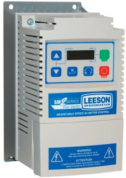

With its power range up to 25 hp, Leeson Electric SM2 Flux Vector Series inverters excel in applications where inverter technology was once considered too costly. They carry four modes of operation — V/Hz, enhanced V/Hz, vector speed, and Torque. Applications include packaging, material handling, and HVAC.
