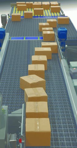

The palletizer uses actuated roller belts that move containers linearly while also moving them left or right, spinning them around, and sorting them to specific locations in a pallet layer. The conveyor belt uses the new actuators beneath various zones and they activate the pinions controlling the longitudinal rollers that make up the moving belt. The pinions make the rollers spin left or right.
Intralox’s actuated rollers make up the surface of the palletizer’s conveyor belt. The rollers can be controlled to turn, spin, or move packages left or right on the belt, getting them ready to form layers on a shipping pallet.
As packages pass over a diversion zone, for example, the rollers move packages sideways by a predefined amount as they also travel forward down the belt. Any given 10-ft section of the roller belt contains eight to 16 actuators, depending on the complexity of what it can do to packages. With this configuration, packages can be nudged a few degrees right or left, or make a complete 90° turn as they move along the belt.
