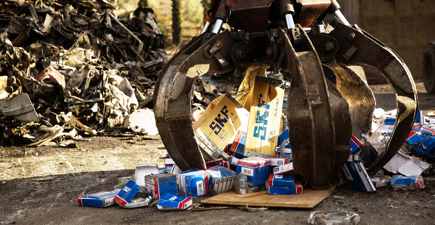

In February of 2017, SKF destroyed 15 tons of fake bearings. Back in 2009, 17,000 pieces of these counterfeit rolling bearings with a market value of over one million euros were seized as part of raid of a dealer’s warehouse in Piraeus Greece. The world of counterfeiting is extensive and reaches several industries.
The obvious first thoughts of counterfeiting are toward high-end consumer goods, such as designer fashions, clothes, and purses. Even electronic items are counterfeited—for instance, items like smartphones and computers are replicated and sold in foreign countries on bidding sites like Ebay.
SKF destroyed 15 tons of bearings, valued at over one million euros, which were confiscated back in 2009.
