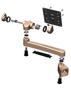

For mounting arms and hardware, ergonomics translates into being easy to position, requiring low force to operate (see "Display-Mount Possibilities"). Ergonomics also encourages correct body positioning on the part of users to avoid repetitive strain injuries and being able to adjust to a range of user physical characteristics and behaviors. For example, a seated or standing person should be able to use the equipment.
Unfortunately, many display mounts and positioning arms do not live up to these goals. For example, many positioning arms let operators swing them into position, but there’s nothing to hold them in place. When the operator lets go, the arm retracts, forcing users to constantly readjust it. Some arms come with locking levers, but these levers may require more than one step to adjust or they may be locked down so tightly that operators may not even realize they are adjustable, and thus don’t bother to try. Other arms are saddled with complicated adjustment settings. They often end up being damaged by well-intentioned health-care professionals and patients who don’t know how to use them.
When fitted with properly designed adjustable mounts, anyone can position a screen with the touch of a finger. Users can interact with the mounted touchscreen, pushing on it as they activate a button or feature onscreen, and the display will not move.
Many display mounts have tilt features that let users adjust the up-and-down angle of the screen to accommodate user height or lighting conditions. Too many of them do not hold position as they wear or age, and the screens drift down to their original position. Users adapt by adjusting themselves to the screen, rather than positioning the screen to suit their preferences.
Mounting hardware should balance two conflicting needs: the ability to reposition the screen, controls, or equipment easily, yet remain in that position when someone adjusts the controls or uses the touchscreen. On top of that, the hardware should be intuitive and easy to use. In short, moving the equipment should be seamless, with effortless, one-touch positioning.

Constant-torque components in mounting applications can overcome several of these ergonomic hurdles. They apply friction that continuously resists motion, but only take a measured amount of force — a simple touch or gentle push — to permit movement.
Constant-torque joints in hinges and display mounts are based around hardened alloy shafts. The shafts are gripped by hardened-steel, torque-generating elements lubricated to generate a narrow range of torque for tens of thousands of motion cycles without additional lubrication or adjustment. The initial lubrication ensures low wear rates. With this construction, the joint or mount can reliably develop high torques in a limited space over the course of a lengthy service life. Properly designed and manufactured constant-torque hinges should last the life of the mount or hinge without maintenance.
Constant-torque components can make arms and mounts easy to adjust and reliable for holding devices securely in a variety of positions over their operational lives.
