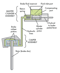

Before we dive into the difference between car brakes, let’s describe the hydraulics behind braking. The hydraulic brake circuit consists of a fluid-filled master cylinder, which connects to a separate slave cylinder. The brake pedal connects to the master cylinder and when pushed, depresses the piston in the master cylinder, forcing fluid along connected pipes. The fluid reaches the slave cylinders at each wheel, which in turn forces the piston to apply the brakes.
The surface area of the combined slave pistons, where the brake-pedal force is applied, is greater than that of the master-cylinder piston. Hence, the master piston has to travel a greater distance to move the slave pistons compared to the fraction of distance required by the slave pistons to apply the brakes. This setup allows for the exertion of a large force by the brakes, comparable to how a long-handled lever can lift a heavy object a short distance.
The hydraulic system used during braking delivers hydraulic fluid from the reservoir to the brake caliper pistons to slow down and stop the brake disc.

The image above is an example of a typical disc brake with a caliper that applies pressure to the friction or brake pads. This friction force slows down the wheel and allows the car to stop.
Disc brakes are typically located on the front two wheels. A caliper straddles a disc and the disc turns with the wheel. Small hydraulic pistons in the caliper operate via pressure from the master cylinder. Friction pads clamp against the disc once the small hydraulic pistons apply the pressure, which slows down the disc and the wheel.
The pistons only move a small distance to apply the brakes, and when released, the friction pads barely clear the disc since they have no return springs. The small gap is maintained by allowing the pistons to slip forward gradually as the pads become worn down. Rubber sealing rings around the pistons make this possible, preventing constant brake adjustment. Modern cars use wear sensors to indicate when pads need replacement.
