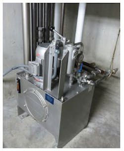

Space constraints and power requirements limited expanding the production size of the current calender. Multiple drives, one per roller, when placed in a new configuration in order to fit, created issues regarding mounting. Whereas a single-drive system automatically distributes power for each roll, a multidrive setup necessitates maximum load requirements per roller so each drive can operate with power to spare.
A central oil reservoir helps keep the machinery cool.
With the help of an engineering consultant, Legg turned to Nord DriveSystems, Waunakee, Wis., which previously supplied drives for most of Legg’s plant. Customizing Nord’s Maxxdrive SK15307V NEMA449TC drives and stacking them three high (with a fourth to the side) ensures sufficient support for the 32-in.-diameter rollers. The drives, based on a helical-parallel shaft design, have an input speed of 1,170 rpm, an output speed of 15 rpm, and a torque rating of 1,850,000 lb-in.
The stacked arrangement lets Legg use shorter driveshafts, but the weight of the stacked units made the overall machine difficult to install. A cast-iron supports lets the stacked units take most of the compression loads, which especially affects bending moments and the bottom case of stack. This additional support ensures the attachment flanges are not overstressed. A central lubrication subsystem fed from a remote reservoir helps control thermal loads.
