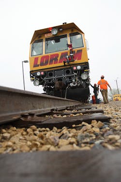

Loram is a railroad maintenance company that was experiencing downtime with its automated rail grinders due to a lack of historical or real-time data. However, new software called FactoryTalk offered remote access and documentation that improved data collection. As a result, technicians were able to reduced grinder downtime. (Courtesy of Rockwell Automation)
