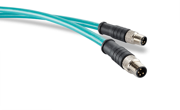

Ethernet connectors are growing more powerful and more compact, as seen with these M8 connecto

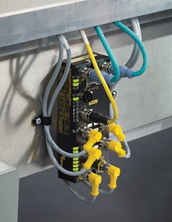

One example is seen with I/O modules and their associated connectors. OEMs are continually looking for ways to adapt their processes to new customer demands without needing to overhaul their operations, purchase new machines, or expand their footprints. Breakthroughs in technology have let automation component manufacturers shrink the size of I/O modules so OEMs can add advanced on-machine communications without reconfiguring processes. The smaller inputs and outputs on these blocks call for smaller connectors. That’s why some companies making automation components are moving from M12 connectors to the smaller M8 designs.
Before it was adapted for Ethernet, M8 connectors were favored for many industrial sensor applications and still remain popular today. The M8 design works well for industrial Ethernet because its pin spacing meets the performance requirements needed for the network and protocol. Performance depends on the location of twisted pairs in the connector. If they’re too far apart or too unevenly spaced, the chances of signal errors and loss increase. Because the M8 meets optimal performance specifications, and carries ingress protection for industrial applications, it can transfer data at up to 100 Mbps while fitting into smaller applications than the M12.
