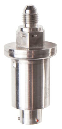

So what makes a good pressure switch for these failure-intolerant off-highway applications? First, the switch has to meet the basic application requirements related to pressure, accuracy, size, mounting requirements, and communications. Second, and equally important, the switch has to be rugged.
The notion of “rugged” can be somewhat subjective, and many vendors claim to have ruggedized switches. Rugged is defined as a stable switching response and long lifecycle in the face of seven failure modes—pressure spikes, leaks, temperature extremes, moisture, chemical exposure, vibration, and shock loads. These switches will address all but the most extreme conditions (see “Extreme Ingress Protection” below).
Switches that can withstand all these seven life-ending failure modes have three design principles in common. They tend to have a piston rather than diaphragm design. They have carefully designed pressure-management features and seals. And they use materials and construction methods that mitigate chemical and moisture exposures as well as thermal expansion mismatches. Here is a closer look at these design principles.

When it comes to operating in extreme environments, the piston-actuated designs have a number of compelling advantages over other types of pressure switches—even those with comparable or even better data sheet specifications. Well-designed piston switches offer accuracies as well as ± 1 to 2 percent with a narrow dead-band, and they can last for up to 1 million cycles. What makes the piston-actuated pressure switch unique, however, is that it does not lose its accuracy or fail early when exposed to harsh operating conditions.

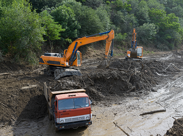

Sigma-Netics recently produced a custom “dry” pressure switch for a large piece of earth-moving equipment. The switch lives on the equipment’s undercarriage, so it’s exposed to moisture and constant thermal cycling.
Just how harsh? Rugged pressure switches need to survive thermal cycling from -65ºF to 250ºF. They have to tolerate shock and vibration loads corresponding to peak accelerations as high as 50 G. They require ingress protection up to IP 67, which keeps out moisture and particulate. They have to tolerate a broad range of fuels and corrosive chemicals. And most challenging of all, they have to survive pressure spikes as aggressive as 1 million psi/second.

With piston-based pressure switches, the cross-sectional area of the piston helps determine both accuracy and repeatability. In general, you want a large piston size relative to the overall size of the switch and strength of the various switch materials. Pistons with a large cross-sectional area are inherently more sensitive to small changes in applied pressure.
Severe pressure spikes are the leading killer of switches in our experience.
Larger pistons also help improve the switch’s hysteresis. Also known as the Delta-P value, hysteresis is the percent difference between the switch’s actuation pressure and the pressure at which it returns to its original state. Because the force developed from an applied pressure rises exponentially with piston surface area while friction forces from the seals exhibit only a linear increase, large pistons lessen the friction component of hysteresis. Put differently, contribution of friction forces to the system decreases in relative terms as piston size grows. In a related benefit, reducing friction from the switch’s dynamic surfaces also improves overall repeatability and the longevity. Keep in mind that piston size is only one part of the hysteresis equation. Many other factors come into play, too, including the design and materials of all mechanical components as well as the mechanical characteristics of the electrical switching element.
Designing a switch with a large piston may sound cut and dry, but it does present some design challenges. Size constraints within the switch package place some obvious limits on piston size, but the more challenging issue involves striking a balance between the size of the piston and a calibrated spring that helps control the piston’s response to applied pressure. The spring needs to be compact, given the size of the piston and the overall switch package. Yet the spring also has response and energy-storage requirements that either increase its size or result in very high design stresses.
Striking a good balance between the size of the piston and the spring is one of the overlooked design differentiators that sets apart a good ruggedized pressure switch from a bad one.

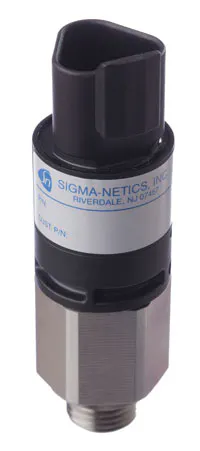

Most ruggedized pressure switches have an ingress protection level of IP 67. And that level of protection is more than adequate for the vast majority of industrial, aerospace, and heavy equipment applications. Sometimes, though, an application will require more protection against moisture or contamination.
We often have to custom-design these switches since most off-the-shelf models do not reach IP 69 or above. For example, custom aerospace switches are available that have been hermetically sealed to 1×10-8 Torr cc/sec He.
Or to take another example, a custom “dry” pressure switch for a large piece of earth moving equipment. The switch lives on the equipment’s undercarriage, so it is exposed to moisture and constant thermal cycling.
To simulate this demanding end-use environment, the switch undergoes a number of aggressive tests. A “power wash test,” for example, subjects a switch heated to 120ºC to repeated blasts of water at 1,000 psi. A “heated dunk test” repeatedly heats the switch to 120ºC and dunks a meter deep in room temperature water. Under these conditions, a heated switch will tend to draw in the cooler water like a straw.
Surviving these tests and the end-use conditions required a custom design that goes beyond what most ruggedized switches can do. To eliminate all the leak paths that would open up as the switch thermally cycled we had to implement a number of proprietary steps related to managing the thermal expansion (CTE) of the switch, its housing, and sealing materials.
