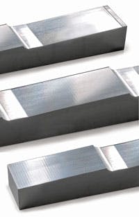

Consider three workpieces manufactured by multipass milling with a 12-mm ball-nose cutter. Each process used a different encoder with a different interpolation error. The results on surface finish are readily apparent, as shown in the accompanying images.
These machined surfaces were generated on a milling machine using encoders with interpolation errors of <100, 200, and 500 nm.
An encoder with an extremely small interpolation error (<100 nm) was used for the first workpiece, in this case a Heidenhain LC 100 Series linear encoder. The workpiece surface appears perfect.
Encoders with larger interpolation error present a different picture. Because the feed axes follow a higher interpolation error, a conspicuous wave pattern appears on the workpiece surface.
The second image shows the result of milling when the encoder has an interpolation error of 200 nm. A wave shape is clearly visible. The last image shows a part manufactured using an encoder with a 500-nm interpolation error. The workpiece surface has a prominent wave shape.
