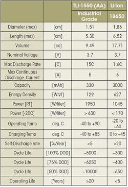

The table provides a comparison between typical lithium-ion batteries and industrial grade lithium-ion batteries.

Rechargeable battery technology has evolved, with lithium-ion (Li-ion) and lithium polymer batteries gaining popularity. Lithium polymer batteries are manufactured in thin, flexible sheets, which is ideal for consumer handheld devices that need to be thin and stylish. Rechargeable lithium-ion (Li-ion) batteries are more commonly utilized in industrial applications.
Generally, industrial grade Li-ion batteries make sense where the expense of battery replacement far exceeds the cost of the battery itself.
Consumer-grade Li-ion cells are reasonably inexpensive and widely available, but drawbacks include a life expectancy of less than five years and 500 recharge cycles, a moderate temperature range of -10°C to 60°C, and an inability to deliver high pulses.
Industrial-grade Li-ion batteries are the preferred choice for long-term deployment in remote and inaccessible locations. They are able to operate for up to 20 years and 5,000 full recharge cycles, provide a much wider temperature range (-40°C to 85°C), deliver high pulses (5 A for an AA-size cell), and feature glass-to-metal hermetic seals, whereas consumer rechargeable batteries use crimped seals more prone to leakage.
