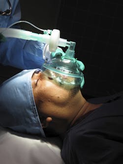

Shown here is a breathing circuit that was assembled using LED-curable adhesives. The adhesives are made by Tangent Industries and are capable of bonding multiple substrates including acrylic, PVC, polyethylene, polycarbonate, and styrene. This wide range of substrates lets engineers connect various components to build products like anesthesia masks, breathing bags, tubing and connectors, and laryngeal mask airways.
