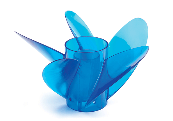

This propeller was for a showroom model that wouldn’t see a load. Stereolithography gave the model the desired look and feel. If the model isn’t in direct sunlight, for example by a window, it should have a long life cycle to serve the showroom.

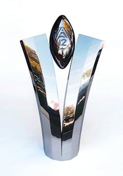

Application: Investment cast-metal trophy
Function: Burn-out pattern to form ceramic shell for casting
Stability: Pattern had to hold shape, be moisture-resistant and watertight
Durability: One-time-use only
Aesthetics: Smooth surface finish
Economics: Quick lead-time more important than price
Priorities: Rapid turnaround time and smooth surface finish
Selection: Stereolithography investment casting pattern, SC 1000 material
Read the full story: https://www.stratasysdirect.com/case-studies/pac-12-trophy/
