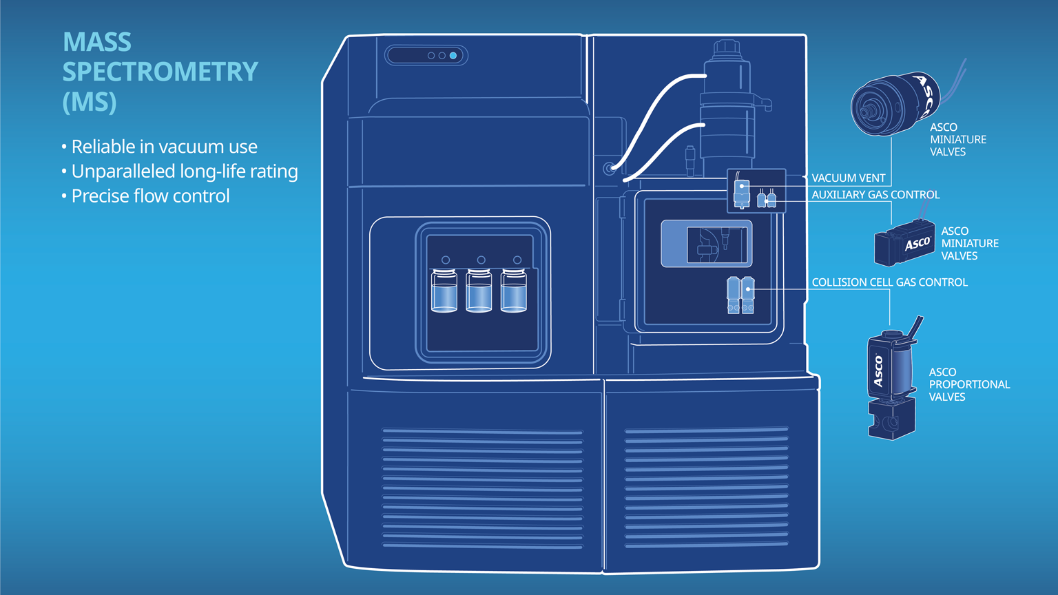

Courtesy of Emerson
Diagram of a mass spectrometer

Mass Spectrometry
Mass spectrometry is another powerful analytical technique that measures the mass-to-charge ratio (m/z) of charged particles. It is used for determining masses of particles and for determining the elemental composition of a sample or molecule. The analysis results are presented as a mass spectrum, or a plot of intensity as a function of the mass-to-charge ratio.
READ MORE: How to Choose the Right Proportional Pressure Control Valves
When a sample is introduced into a mass spectrometer, it is first evaporated at high temperatures, and then ionized to become either positively or negatively charged. Nitrogen gas is used to aid in solvent transportation and sample nebulization and evaporation. On/off or proportional valves provide proper flow control of the nitrogen gas, ensuring the stability and sensitivity of the mass spectrometry results. A low flow rate (around 0.2 liters per minute) is required for maximum accuracy.
Next, a “collision gas” such as argon is introduced into the collision cell where ions are broken into fragments as they collide with the argon molecules. Proportional valves control the argon supply into the collision cell. All mass spectrometers operate at very low pressure (high vacuum). Therefore, the valve’s ability to achieve and maintain an effective vacuum is vital to the process. General-service valves with high tightness and vacuum operation capability allow the vacuum manifold to be vented and refilled with dry nitrogen or filtered air.
